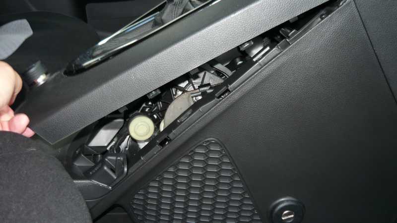

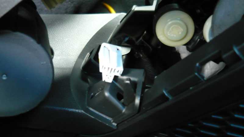

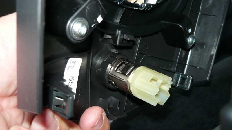

TAK JSEM TO ODHALIL. PROTOŽE MĚ DĚLALI MULTLOCK, BYL TROCHU ODCHLÍPNUTÝ BOČNÍ KRYT U TÉ SPODNÍ PALUBKY. ZABRAL JSEM A ONO TO POVOLILO. DOSTAL JSEM SE TAK ZE DRUHÉ STRANY K ZÁSUVCE A ZJISTIL, ŽE DO NÍ NIC NEVEDE. ŽE BY ZAPOMNĚLI NA KABEL SE MI NEZDÁLO. PO CHVÍLI JSEM OBJEVIL BEZPRIZORNÍ KONEKTOR A ZÁHADA BYLA VYSVĚTLENA. ASI TO MĚLI ODDĚLÁNO PŘI MOTÁŽI MULTLOCKU A PROSTĚ TO ZAPOMNĚLI VRÁTIT. UDĚLAL JSEM PÁR SNÍMKŮ, ALE CELÝ KRYT TUNELU JSEM NEMĚL ODDĚLANÝ, PROTOŽE TO NEBYLO ZAPOTŘEBÍ, TAK NEVÍM, JAK JE TO UCHYCENO V MÍSTĚ POD VSTUPEM PRO CD, ALE PAK BY SE MUSELA ODDĚLAT I ŠALTRPÁKA, KTERÁ TO OMEZUJE. ODMONTOVÁVAT OD SPOLUJEZDCE, JE TAM VÍC MÍSTA A ZÁPADKA NA KONEKTORU JE NATOČENA TÍM SMĚREM ŠIKMO NAHORU. OTVOR JE NA 2. FOTCE PĚKNĚ VIDĚT
POKUD TO CHCE TAKY NĚKDO ZKOUŠET, JDE TO DOST ZTUHA, ALE ÚCHYTKY JSOU FESTOVNÍ, MYSLÍM, ŽE SE NEULOMÍ (OPAK U KRYTEK OSVĚTLENÍ)
KDYŽ JSEM ZABRAL, PĚKNĚ SE TO ODCHLÍPLO, ALE NEJDŘÍV TO JDE DOLE, NAHOŘE U CD TO BUDE TĚŽŠÍ - NEZKOUŠEL JSEM

ZÁSUVKA BEZ PŘÍVODU?! ŠROUBY JSOU OD LEMU ŠALTRPÁKY. JE VIDĚT OTVOR PRO ZÁPADKU
BEZPRIZORNÍ KONEKTOR, Z BOKU MÁ 1 ZÁPADKU, KTERÁ SE MUSÍ ZATLAČIT PŘI ODPOJOVÁNÍ OD ZÁSUVKY
