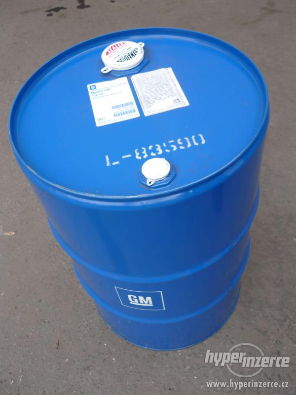

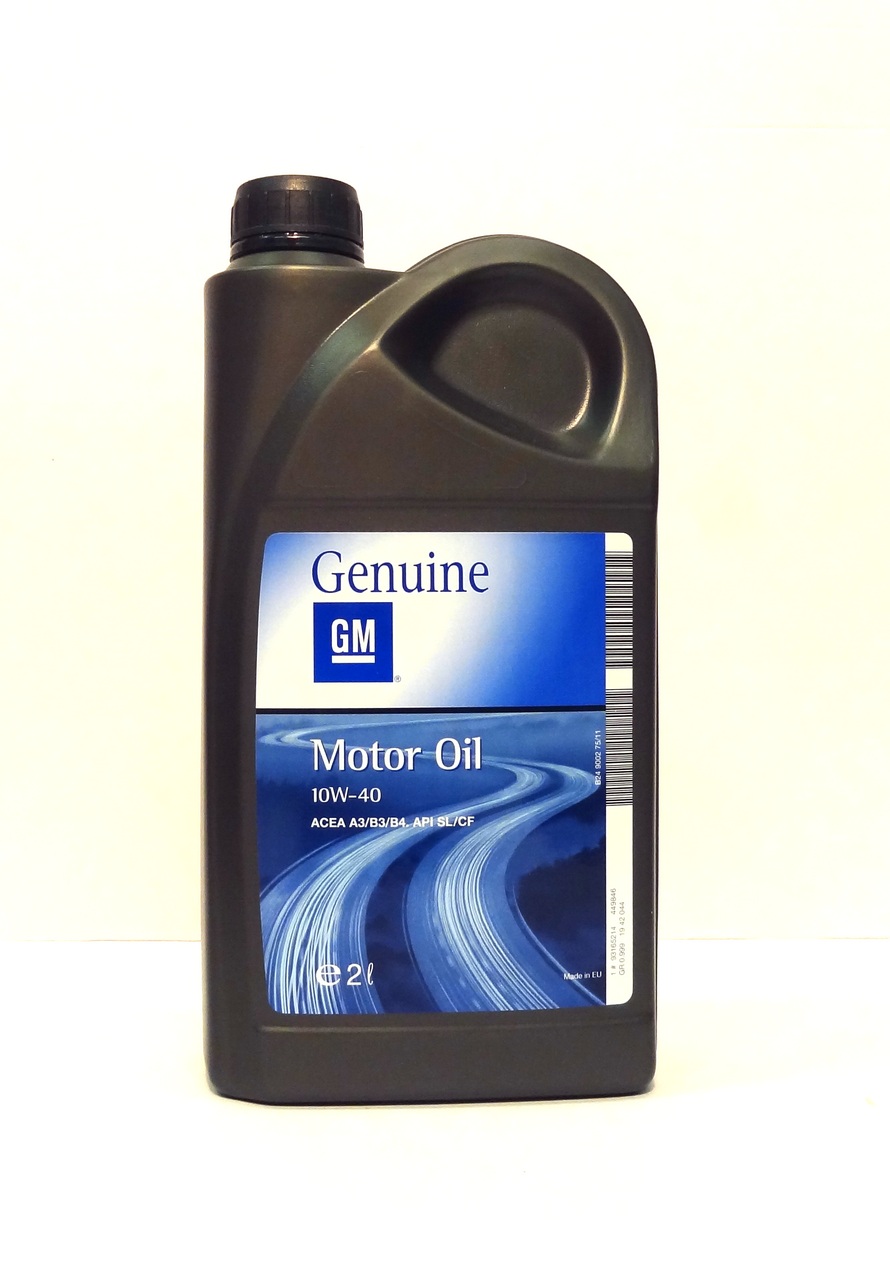

Viete kto dodava pre GM olej :?: :?: :?:
:D
GM Genuine Motor Oil 10W-40 ,15W-40
GM Genuine Motor Oil DEXOS 2 SAE 5W-30
gm 8.jpg (4.68 KiB) Zobrazeno 10647 x
GM Genuine Motor Oil Supreme Plus 5W-40
