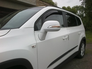

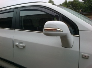

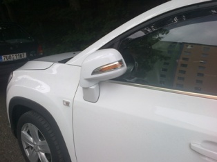

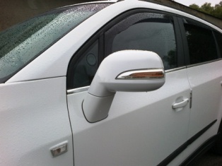

AHOJ PÁNOVÉ TAK BYLA TO FUŠKA ALE DAL JSEM TO , KOMPLETNÍ DEMONTÁŽ A MONTŽ ZRCÁTEK VČETNĚ NATAŽENÍ ELEKTRYKY NAPOJENÍ NE TO RADŠI OPRAVDU NECHÁM NA PROFÍKA , POŘÁD JSEM VÁHAL ABY JSEM NĚCO NEPOKAZIL TO AUTO NEZNÁM , PRVNÍ ZRCÁTKO BYLO HRŮZA SKORO 1,5 HODINY PRÁCE ALE TO DRUHÉ UŽ JSEM VĚDĚL TAK CCA: 45 MIN KOMPLET JSEM SPOKOJENEJ A DOOOOOOOST JSEM UŠETŘIL BYL JSEM V SERVISU A TY JEJICH VÝKRÚTY KOLIK S TÍM JE PRÁCE A ŽE TO BUDE NA 5 HODIN MINYMÁLNĚ A JEDNA HODINA 700 KČ MAZEC CO? JINÁČ ROZEBRÁNÍ BRNKAČKA TADY NĚJAKÉ TO FOTO
FOTO
FOTO

FOTO

Takze komlplet home instalace? -i
Muzes hodit fotku jako celeho auta a taky jak to sviti?

AŽ TO NAPOJÍ A UDĚLAJ MI POLEPY TAK TO NAFOTÍM A DÁM NA FORUM CELÉ A VEZMU TO POŘÁDNÝM FOTÁKEM A NE MOBILEM
